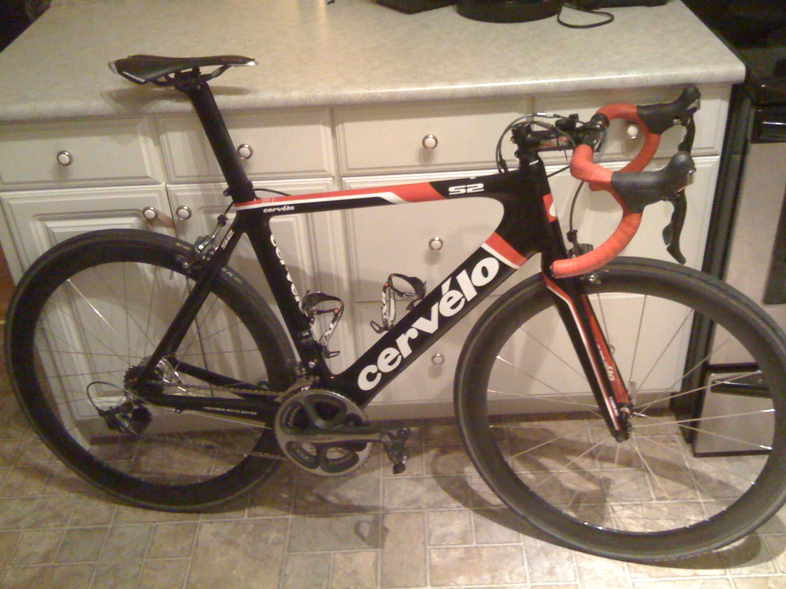

The new geometry from the Cervelo R3 and S5 series has a taller headtube so that people can put their handlebars on the correct height without needing too many spacers. At the same time the bars can still be placed low enough to fit any pro rider we have ever supported. The advantage of a longer headtube is that it increases the torsional stiffness of the frame, which in turn improves handling.
On aero frames, it also improves the aerodynamics because despite the headtube being wider than the bunch of spacers sitting atop of it if it were shorter, the shape of the headtube is much, much better and more than compensates for the increased frontal area.
Lainaus:
Of course, that said no pro should ever ride the R3 except for Paris-roubaix (which it was designed for originally). The aero frames are ALWAYS the fastest solution, even in mountainous terrain, so every pro taking their profession seriously and wanting to get to the finish the fastest should ride them at all times (except Roubaix).
