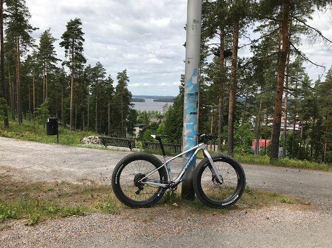

On se vaan kiva peli....
http://i96.photobucket.com/albums/l1...a/IMG_1525.jpg
