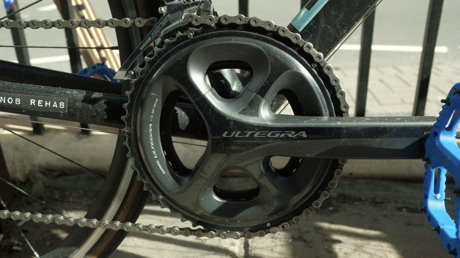

    Shimano 11s Ultegra- ja Dura-Ace kampien takaisinveto
    Vois mennä Voe Bergele topiikkiin myös... Koskettaa omia kampia myös, joten täytynee irroitella ja tarkastaa löytyykö vaurioita.
    Affected cranks are the following models with the following product codes:
    • 11-speed Ultegra FC-6800
    • 11-speed Ultegra FC-R8000
    • 11-speed Dura-Ace FC-9000
    • 11-speed Dura-Ace FC-R9100
    • 11-Speed Dura-Ace FC-R9100P (this is the power meter variant)
    This also includes any third party power meter cranks (Stages, Pioneer, 4iiii). Affected manufacturing codes are:
    KF, KG, KH, KI, KJ, KK, KL, LA, LB, LC, LD, LE, LF, LG, LH, LI, LJ, LK, LL, MA, MB, MC, MD, ME, MF, MG, MH, MI, MJ, MK, ML, NA, NB, NC, ND, NE, NF, NG, NH, NI, NJ, NK, NL, OA, OB, OC, OD, OE, OF, OG, OH, OI, OJ, OK, OL, PA, PB, PC, PD, PE, PF, PG, PH, PI, PJ, PK, PL, QA, QB, QC, QD, QE, QF, QG, QH, QI, QJ, QK, QL, RA, RB, RC, RD, RE, and RF.
